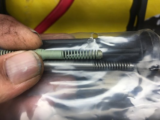

Got a little bit of time this morning, I was having a look at the plug boot NGK part number CPB-cr010 that I ordered and first I noticed no resistor with it, I take a spring out of an old boot and it’s roughly 3/4” shorter than the new spring? I’m going to double check but I was sure I ordered with the resistor and also I ordered from RA using the drop down menu picking my model, year and engine. I guess you can’t really trust that to be ordering the right parts which is a little odd.

Double checked, info for her part I ordered says it includes all springs and ferrite resistors?

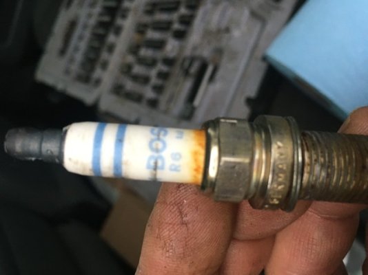

I took the from plug out of cylinder 3, it had the markings Bosh R6 Iridium on it, gap looked pretty big on it, I’m no expert plug reader but the plug looks like that cylinder was running pretty rich to me. I’m going to label all the plugs from which cylinder they came out of for future reference, also going to go ahead and take all the coils off, label them as well and clean them up. The resistor looks to be about a half inch and the new boots don’t have resistors with them buy the springs are about 3/4” longer than the old springs. I’m thinking I will just go ahead and use them? I think I could have gotten away with just new resistors as the boots are in good shape, but I have these parts now and I don’t know if the resistors are even available separately.

The instructions on the new boots say to put a little di electric grease on the inside of each end of the boot, sounds to me like they are saying to put it on the rubber and not on the spring? Does this sound right? Makes sense to me, non conductive grease on the inside of each end of the boot to keep moisture out? What do you guys recommend?

Put the dielectric grease on the bottom of the plugs porcellin,instead of inside the boot. I switched the plug boots over to the earlier boots with-out the resistors on both the truck and 6.4 Challenger. It doesn't hurt to stretch the new springs out about a 1/4 to 1/2" ,as it puts a little more pressure on the contact points and they're a little less likely to corrode as fast. A little WD40 sprayed on the boot helps when you re-install it into the coil.

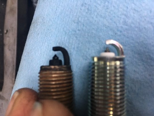

Thank you for the advice, here’s the plug out of cylinder 4, pretty unbelievable the amount of corrosion. I’ve already changed the plugs for cylinders 1 through 4 and haven’t put any anti seize on the threads, I will start brushing on a very thin amount for plugs 5 through 8. I have torqued the plugs to 10 foot pounds,

Those are definitely in rough shape,lol. The spring makes contact with the top of the plug,so the corrosion on the side isn't to big a deal,but still not great though.If you plan on keeping the truck long enough to do another plug change on it,i'd pull the 8 plugs out that have no anti-seaze and put some on them,if you don't plan on ever doing plugs in it again,i wouldn't worry about it,lol
