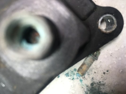

I took the coil off what I believe to be cylinder 2? Does the left bank (drivers side) Include cylinders 1,3,5,7? It was a little tough getting the resistor out of this coil 2 and when I did a fairly large amount of this green crude sifted out, the end of the resistor that was inside the coil is gone, maybe it’s logged in the coil or maybe it disintegrated? But it’s not part of the resistor anymore. Is there anything to clean in the coil once the resistor is removed? Am I correct in thinking this coil is done just based on the corrosion in it? I mean I believe it could possibly still work but the corrosion in it, is crazy? Oddly I think this is cylinder 2 and it was cylinders 3,7,8 that threw the misfire code ( not my scanner or me scanning it)

Take a small pick and you should be able to get the rest of the resistor out,then use the dremel brush i posted the link to.Between some scratching with a sharp pick and wire wheeling you should be able to get the screw head cleaned up and the coil will be back to almost new again,you might want to order all new boots from rock auto as they come with new resistors and springs. With a bit of work your coils are rebuildable. I've upgraded a few sets of coils using the older coil boots that don't employ the resistor,which from my digging around is only there for am radio reception.The coil boots for a 2013 Chyrsler 300 with the 5.7 use longer springs and don't employ the resistors,i don't think the resistors came into use until 2014,before that the coils used longer springs and no resistors.Once they started using the resistors is when corrosion became a bigger factor,before that the coils would still corrode,but not to the extent they do with the resistors in place.
By no stretch would i write those coils off,an hour of scratching and wire wheeling will bring them back,and is far cheaper then buying new OEM coils.Whatever you do,don't buy any ignition/electrical parts from Amazon or Ebay,it might say Mopar on the box,and seem to come from a legit seller,but there's a good chance it'll be a chinese knock-off look a like.Stick with either the dealer or a legit place like Rock Auto to buy your ignition or electrical components from.

Thank you, thank you, I will scratch away tomorrow, I won’t be able to do a full cleaning until I order that dremel attachment, I will have a look tomorrow and see what i have for my cheap rotary tool, what’s your take on this coil from cylinder 2 being so badly corroded and not showing up as a misfire on the fellow’s reader? His scanner showed misfire on 3,7,8

Makes me think all your coils need a touch of cleaning,and if it's still firing through that corrosion,there's nothing wrong with the coil itself,that a bit of cleaning and new boots won't fix. I just did my buddies 2016 Scat Pack Challenger a few weeks ago,the car only has 18,000 kms/roughly 12,000 miles on it,and his coils were showing a fair bit of corrosion,even at that low of milege,enough he was surprised as hell,and now he says he'll be taking the coils off every winter while the cars parked and cleaning them the way i showed him how to clean them.The resistors in his were crudded right up and the car has no miles to speak of,which is making me think the resistors are an issue and are a factor in creating the corrosion.

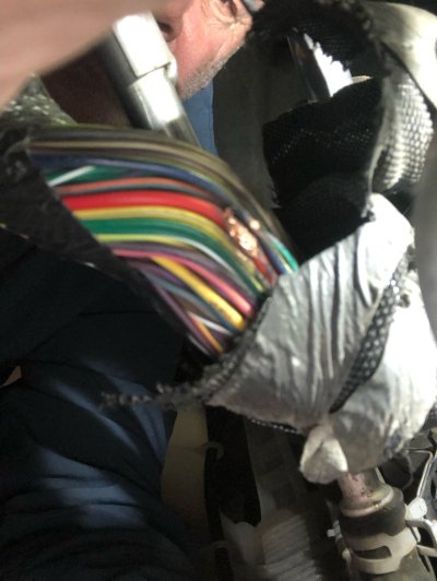

I had a similar issue on my 2017 Power Wagon. I was getting a misfire on the #8 cylinder and thought I had a lifter failure. Mine turned out to be a cut power wire for the #8 cylinder coil that shorted to another wire that got cut. There was a heater hose clamp rubbing the wire bundle and it finely cut through. A local shop doing the diagnosis repaired it and moved the clamp into a different orientation. Knock on wood its been running good since. Just something else to check.
This short also took out the diodes in the computer for cylinder 8. Had to have the computer replaced as well.
