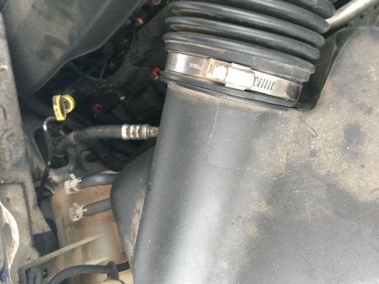

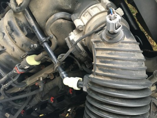

@Wild one you May be right, I’m starting to think my truck doesn’t have a MAF sensor, even though ones listed for it at RA as well as all the Mopar sites. However on the Mopar sites it states it’s also referred to as other names. I’m just sitting in the parking lot of grocery store now so I will post some more specific information later. @White six four what engine is on your truck?

If that's the only sensor in your airbox and intake tube, you don't have one Burt.
Wonder if the early built 16's used one and the later built 16's did away with it.
I know they only used a maf sensor on the early 15/16 Hellcats then they did away with it.
That's all i got,lol
