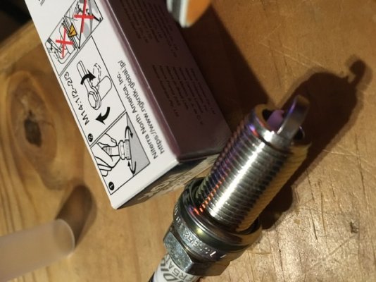

Don't forget your 6.4 uses a differant plug then the 5.7 does.The 5.7 uses a flat seat plug with a washer,the 6.4 uses a tapered seat plug with no washer
I hope these are the right plugs? I got them from Rock Auto, NGK 4469 LFR5AIX-11. This plug has a washer, but the washer is tapered in the bottom side of it.
Jan 17, 2016
23,879
54,972
14 Sport
I think those are 5.7 plugs,you're 6.4 should use plugs with a tapered seat and no washer.
Pull one plug out and see if it matches

Darn, I just assumed that if I picked from the drop down menu on Rock Auto 2016-Ram-2500-6.4 they would only offer the correct plugs. I’m going to check the drop down menu and see if they offer these same plugs for the 5.7.
Instead of doing that,go pull a plug out of the engine,and order the same plug as what's in it now.
I could be wrong and so could rock auto,so verify what you actually have
A couple minutes checking your old plugs,will make sure you're getting the right plugs

Rock auto had that plug listed for both the 5.7 and my 6.4, I looked at the pictures of about 4 of the plugs offered for my 6.4 and they all had washers. I hope I’m not stuck paying 20.00 per plug from the dealership
Thanks @Wild one , I will pull a plug tomorrow.
