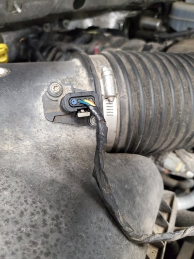

If you can,please gat a pic of your airbox,i've never really looked a truck 6.4's airbox over close to see if they do use a Maf sensor.
I thought only the early 15 and 16 Hellcats were the only VVT Hemi's to use a maf,did not know the 6.4 truck's still used one.
I've modified 4 Hellcat boxes and tops to fit the naturally aspirated 6.4/5.7 Challengers and Chargers,and the early Hellcat lid with the Maf sensor hole is the easiest one to make fit,is why i know the early Kitties used a Maf sensor,the later 17 to 19 lids still work,i just find the early tops to be easier to mod,lol
Absolutely no problem, that’s the least I could do
