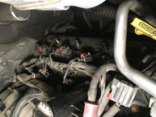

I think I went at the wrong side to take the valve cover off? I’ve been trying to take the left side (drivers side) but I’m not seeing how it’s going to come out? I’ve taken the electrical clips off the injectors, all the clips off towards the front but the harness will only move so far due to it splitting down below. And the oil dipstick tube is in the way, as well as the oil fill pipe. I was originally taking this side off because the misfires were in cylinders 3, 7 and 8... is it possible to get this valve cover off without removing the air conditioning lines or the dipstick filler tube?? The bolt for the tube is in a location upside down that I don’t think I could get it off

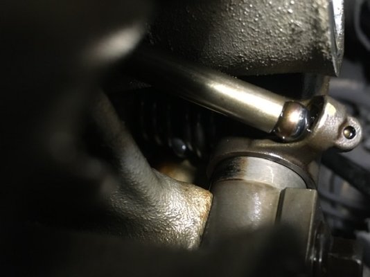

I got that valve cover out, basically undid ever electrical connector I could see to allow the harness to move a little, then after fighting with it for an hour finally figured to slide the cover down and tilt while pulling on harness was able to to get the harness under the cover and then still very tight to get out.
ANYWAYS I think I found the problem the pushrod is about 1/4” to 3/8” away from the rocker arm. To me that’s saying hydraulic lifter or cam or both or possibly bent pushrod but I don’t think so. ?? What do you guys think? And what is my next step? Anything you can think of that may help me, through the next steps is very appreciated. This is my first time really except for the 1985 Tempo being inside or even around a 4 stroke engine so my understanding of everything is pretty non existent

Next step is remove the intake manifold,then pull the VVT solenoid and see how much metal is on it's screen.The VVT solenoid is the one that's on the front of the engine horizontal with the ground,the 4 MDS solenoids are in the intake valley and run vertical.

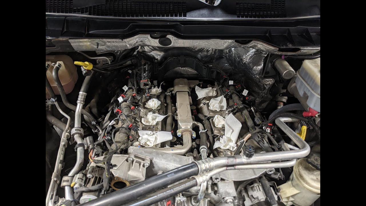

Is that exhaust type looking thing down the Center the egr cooler?
