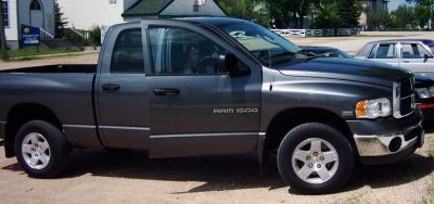

Here's what she looked like in 04 with the 245/ 17's.

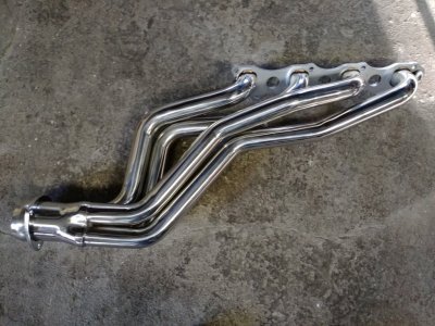

First up, DNA SS 1 5/8" 2WD headers.
Will they fit an 04 4x4!!????

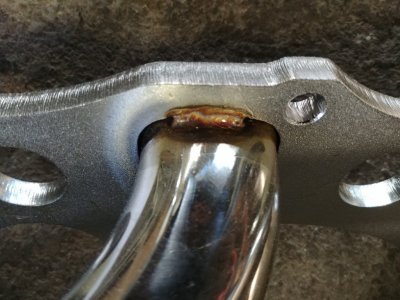

Cpl pics but more to come tomorrow. Was surprised to see just how rusty the exhaust manis and bolts were on this ol girl given only 120,000kms now. Was a little concerned about the stories I'd read about breaking bolts.
I sprayed them all down in Kroil but I think the trick is I took my time, starting with the 10mm heads and within 1 or 2 turns back and forth the crust came off and socket was loose. Tapped on a 6 point 3/8" and was nice and tight. continued carefully and off they came. I think I only had to drop from 3/8 to 9mm on one because it was extra crusty.
The 13mm bolt I did the same, Always 6 point sockets and some came with the 13mm 6 point, some crusted off and I dropped to a tapped on 12mm and off they came.
My biggest concern with these being listed 2wd only was the pass side. Looking at as many pics as I could, the pass side header looked the most different with 2 pipes going further back and down than any I had seen before. Visually it looked like there would be space and they did that to clear pass side starter?
Long story short, they fit like a Glove! I thought I would at least have to dent some areas or something, but man, they bolt on and clear everything with zero modification!
Also thought I would be pulling out the dremel to clean up poor welds, weld splatter or have to port match like just about every other header I've seen, but these things are so well made that there's nothing to do, and I'm a Very attention to detail guy!
I'm going to be purposefully negative as if I were comparing these to the best header I could buy at any price to give an accurate comparo;
The Good;
Full 3/8" mild steel flange. You want a 304 SS header, but you want the flange mild steel unless it's cut or you cut it yourself because it will move around enough to snap bolt, just how SS moves.
1 5/8" 16 gauge 304SS tubing. (This is the only 1 5/8" header I can find. anything larger would be wasted on my application)
Pipes run right through flange and nicely welded top and bottom on outside and continuous on inside.
Proper 100% port matched square flange with ends of pipes enlarged and shaped to match ports. (this is Da Bomb and something I haven't found in any headers I looked at!)
Gaskets that came actually look very good and I believe I am going to copper spray them and use. (was not original plan because of what I've read, but going with gut on this one)
Gaskets are a perfect match for header ports and perfectly line up with exhaust ports on Hemi, leaving about 3/32" evenly around port for zero overlap and perfect entrance to header!
Collectors are inside welded nicely ass well.
The Bad;
Not equil length. (not bad for me because that usually mean more tork!)
While the bends are decent, not 100% perfect mandrel and some sharper than you would want in a race header. (which simply means, Again, more tork and slightly less top end HP flow)
Collectors are nicely inside welded, but lacking cross hair deflector to make it Perfect. (I said I was going to get picky to give an over all picture, so yeah, really no difference there but in a full out 1000+ dollar set of headers you would want to see that.)
Big shout out and Thanks to Max1329 Who has these headers on his Ram and has been most helpful, anserwing every Q I've had along the way!
Can't think of anything else right now, any Q's or requests just ask, more pics and info tomorrow!
