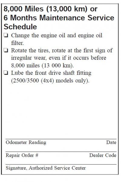

OP-Where did you see 8000 miles in the manual? I haven't looked in mine, but I read the book in my mom's 09 and it specifically says to never go over 6000.
mitchman
Dec 29, 2010
753
SC
2010
And that's the first oil change you're supposed to do? Crazy!
garner
Nov 15, 2010
3,979
85
Harker Heights, TX
They're seems to be some confusion though about the second and so on oil changes. My dealer sticker says in 3,000 miles but the owners manual says in 8,000 miles
