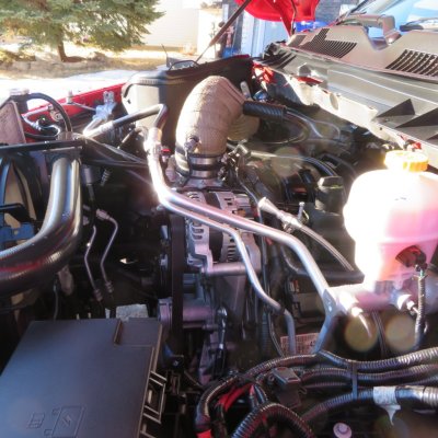

Daw14
Nov 29, 2017
3,445
5,525
South Florida
I used a 3/8 tube bender to put approximately 8* bend ,about 3” from where the tube enters the block.
These were ARH 1 3/4”.
It accepts the dipstick with out any resistance.
I did air conditioning and have bent miles of tubing, so that helped to eyeball the measurements.
