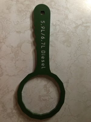

I will probably stick with the Strata due to the Fluted end.
I like the fluted end filters - my wrench fits them perfect & makes loosening them a snap. As well as snugging up the new filter: It's a tight fit going on through the fender well.
My opinion: The Stratapore & BDL are the top choices for a single filter system.
I might even throw this out there - The Fram Ultra & Royal Purple filter are good choices as well! All are very high quality (wire Backed) Synthetic Media filters.
Here is the filter wrench I use:
