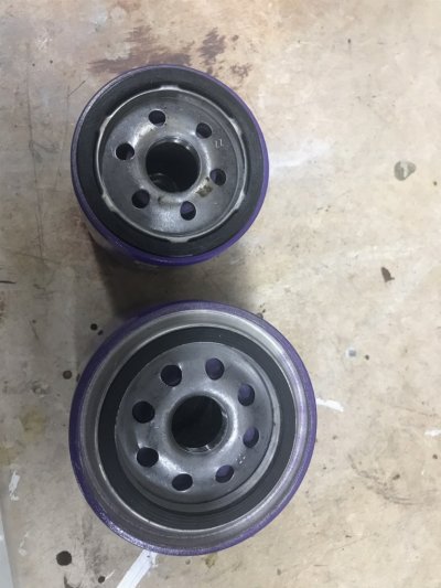

I have been running Redline 5W-30 and a RP 10-48 filter in my ‘16 5.7. I recently read some discussions about oils and noticed some folks are running a RP 20-820 oil filter on theirs.
I snapped a couple of pics to show the huge difference in filter size and I assume filter surface area.
I don’t mind running a non-standard oil filter to gain the advantage of more filtration but I am not sure if I am opening myself up to other issues. Will there be clearance issues in the already tight area the filter is located?

The forum experts say it fits...with or without electronic steering models. I stick with the RP10-48 because I cant imagine working anything bigger in there...I have had a few “frustration posts” on here, usually after I do the change....My OCI w/RL5w-30 is usually 4k, never sees 5k, so by my math im good. Probably overly so, but Id like to hang on to this thing for a decade too.

The larger one is from the non electric power steering days. Both fit, I personally run the larger one and i think it takes an extra half quart of oil

I ran just over 7 qts with the 20-820 as my truck seemed to take just shy of 7 qts with the standard filter. It fit. It was a little more of a knuckle buster with the bigger filter but doable. I have a 2017

Changed the filter to the 20-820. Plenty of room for it. Added a Fumoto valve to make oil changes a little easier going forward. Added a little over 7 Qts Redline 5w-30 to make up for the larger filter.
I put a gallon ziplock baggie around the old 10-48 filter when taking it off. Worked like a champ. Almost no leakage of oil outside the baggie. Just have to take your time taking the filter off. Nice way to keep the messy filter contained for disposal as well.
