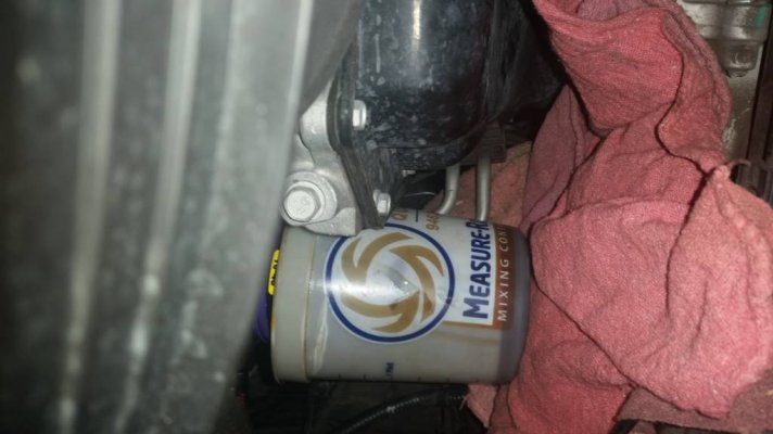

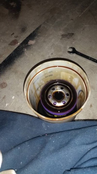

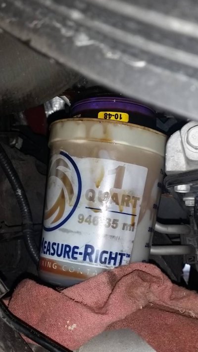

I think the remote filter is cool , but I've never had an issue with the filter location on my 14Ram 5.7L.
I just use a 1qt plastic container( paint Dept at Lowe's) to catch the oil and I've never spilled a drop.
I drive up on ramps and approach from the front , lay a couple rags down break the filter loose by hand then put the container in place , loosen the filter a bit so it drains in the cup then spin it off and let it fall in the cup and finish draining .
Hope this helps !1df192115200652386289cce34934540.jpg1e69806bb6475b8eb3aa6c2a98d13a6f.jpg6d4dc49b8f4ddfaf72ef0a2aef6a0be0.jpg

Yeah that was my plan......just using a bag instead of the plastic container.

I tried the bag but couldnt get the bag back out without dumping some (most) of the oil.
Next time I will try the paint container instead.
R.L.K.
Dec 1, 2013
12,803
12,508
Bristol , Tn.
Works like a champ ...you won't spill a drop !
