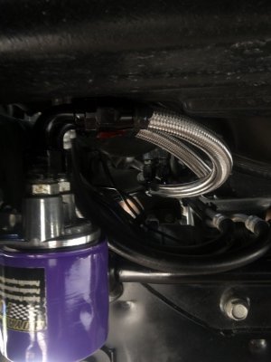

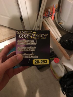

Yeah, it’s a Royal Purple 20-253 (readily available at most Auto parts stores), got mine at Pep Boys.

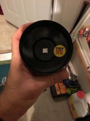

Also, if you look in the pic the filter is a little dented up as I used a strap filter remover. Get a oil filter wrench that fits on a 1/2” or 3/8” drive socket (I can’t remember size, I believe large or second largest size, but got mine at O’Reilly).

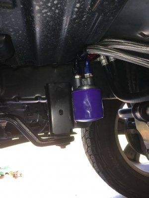

Looks good....... also looks like it’s mounted closer to the bed of the truck? Or is it just me

The 30-8A Royal Purple filter is the bigger filter that'll fit your adapter,the 20-253 is the small filter

On the frame, near where the tow hook mount is

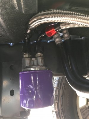

As you can see the filter mount is butted up against the vertical frame tow hook mount. You can also see, the hose and fittings are a little tight at the top and slightly touch the lower portion of the fan shroud. That’s what I would change about it’s position if I did it again, a little lower on the (horizontal) frame.
I will mention, I drilled and tapped the frame and tapped the holes on the mount (there’s 3) so there is more purchase and rigidity on the frame than just using the supplied self tapping screws (into the frame).
