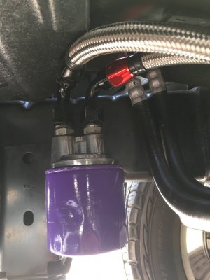

As you can see the filter mount is butted up against the vertical frame tow hook mount. You can also see, the hose and fittings are a little tight at the top and slightly touch the lower portion of the fan shroud. That’s what I would change about it’s position if I did it again, a little lower on the (horizontal) frame.
I will mention, I drilled and tapped the frame and tapped the holes on the mount (there’s 3) so there is more purchase and rigidity on the frame than just using the supplied self tapping screws (into the frame).
Sorry please read below
