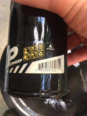

Product Defect Alert!!!!!!!!!
Wix xp oil filter I was putting on was wobbling as I spun it on, the Nut portion of the oil filter was not straight Inline with the rest of the oil filter housing. Making it wobble as I spun it on, resulting in one side of the seal meeting the engine block first as I tightened it down. This defect resulted in a bad seal; took it off and replaced it with another new Wix xp oil filter I had and it had the same defect. So, if your running this oil filter or have one you intend to use this is something to be looking for. I always do a visual inspection on all my oil filters before I put them on and this was something I could not see until I was spinning it on.

Part # for the faulty filter?

Thanks, so not concerning RAM owners then? at least not Hemi 5.7 that uses 57060XP right!!?

Correct two different part numbers as of today. Last year when I got my new truck they shared the same part number so there may be a few using the old part number. Hopefully know one will a mess under their truck like I did.
I was in a pinch for an oil filter so I went with the tried and true M1-113A EP. Spun on flat and snug. Looking at the Purolator Boss for my new filter selection.
