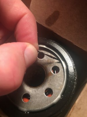

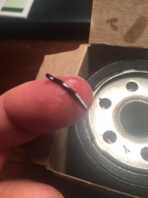

M1 oil filter product Alert!!
Was changing the oil on my gf Honda today and when I looked at the used oil filter I noticed part of an inner seal was broken and getting sucked into the filter. I've never seen an inner seal like this before, but after looking under the lip of the filter you can see it on the M1.

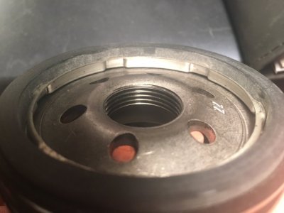

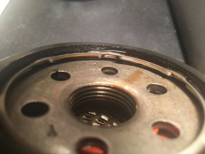

Just a little added info:
2nd pic is the defective oil filter off the Honda, M1-110A. You can see a little gap were the seal was, you can also see part of the seal in the inlet hole of the filter. After looking at it a second time 90% of the seal was missing, got sucked into the filter media. Hopefully nothing made it through the by-pass valve. That's the bad news.
Good news is the M1-113A in the first pic does Not have this seal, and that's what I was worried about.
I'll be looking for this on every oil filter moving forward.
