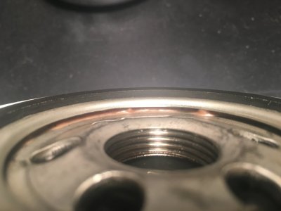

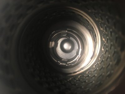

Was changing the oil on my gf Honda today and when I looked at the used oil filter I noticed part of an inner seal was broken and getting sucked into the filter. I've never seen an inner seal like this before, but after looking under the lip of the filter you can see it on the M1.
That is the sealer for the tapping plate. Latest Mobil 1 EP filters have shown a lot of this and Champion Labs response has been they know about it but are not worried about the ones already out there since any pieces will be caught on the filtration side of the media and not get through the flow side to the engine.
Is this just with the M1 filters or more of the Champ lab upper tier filters as they seem to make most of the filters now.

I have only seen it with the Mobil 1 EP 20K mile rated filters, nothing else and nothing even remote the same with the Royal Purple filters that Champion Labs also makes.
There is a more than a few threads on BITOG on this and seems to have shown up mainly when Mobil 1 rolled out their 20K mile extend oil and oil filter with the "A" suffix on the end of the part numbers. Champion Labs has stated in the past that they build to Mobil 1's specifications for their filters and something changed recently when they relaunched with the new 20K mile rated Mobil 1 filters. I believe Champion Labs is going to address it in sequence production going forward but are not worried about what is out there as previously stated since any errant sealant will be caught on the filtration dirty side and not pass through.

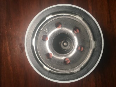

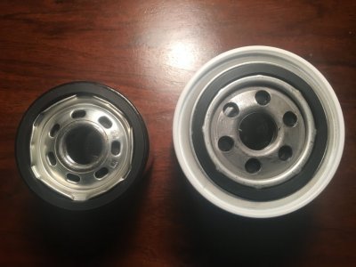

Mopar MO-041 (SRT oil filter) on the right, I included the "recommended" oil filter from the dealership on the left for comparison.

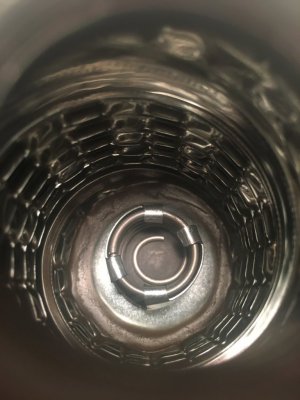

Unfortunately there is glue or some kind of sealer under the bottom lip of the base plate. This is the same kind of problem the M1 had.
