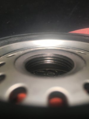

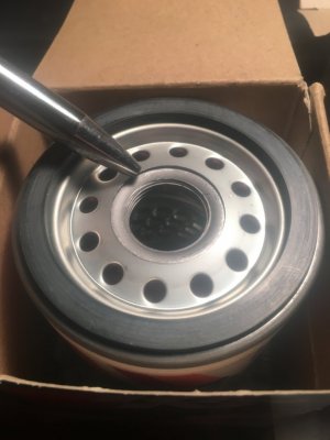

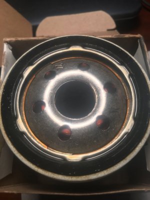

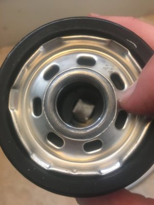

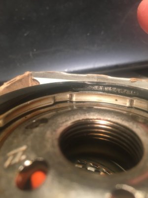

!!!Attention product alert!!!
K&N has drastically changed their oil filter design on the HP 10-17; not sure about the others in the K&N lineup.
You can see on the new design the base plate has been replaced with a thin layer of steel in the new two piece design. It the cheapest piece of junk I have ever seen. See pics.
The thread cout has been reduced also. See pics.
And the bypass valve has been replaced as well; it had the spring style design before. Now it has the plunger. Can't say that is worse or better.
Looks like K&N has gone the cheep route; if you're using this product I would reconsider. Considering the cost I think it's a joke.
I included photos of the old and new oil filter for comparison.
First pic: Old Filter
Second pic: New Filter
Third pic: Side by side comparison
Fourth pic: New bypass valve

good posts thanks Hammer, I guess they felt it was necessary to save .004 cents worth of steel or something. It is how everything goes these days, fkin idiots.
I will say I do like the cheese grater, this is an upgrade many manu's are going for.
Ramnewbie
May 8, 2017
3,029
3,884
I think you have them reversed, the first pic is the one we currently have in the store, the second pic is the one we had before, with all the inlet holes. That is the one that I had leak. The second one is made in Mexico, first one in USA.

That's his point, less threads in the second, may have something to do with the leak?
Sent from my VS996 using Tapatalk
That could be, the parts store could of have had an old filter left on the shelf. When I take it back I'll look at the others.

Well yeah, plus the threads on the second one aren't actually a part of the baseplate, they are a seperate piece attached to baseplate.
Quality going down ...

Had a chance to go back to the parts store and return the K&N oil filter. Before I did I confirmed it was made in Mexico. There were to other HP-1017 oil filters and both were made in Mexico as well. Drove across town to Walmart and every K&N HP-1017 on the shelf was made very well with good quality. Looks like an M1 clone to me. Either way there are still some Mexican made oil filters in circulation. Buyer beware.

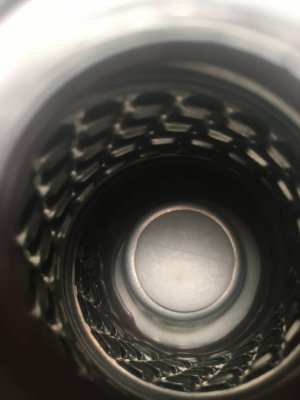

I hate to say this but the new RP 20-820 has that same plunger type bypass valve....4653b89168028425631c6c3e158b3c42.jpg
I think the new plunger design could be better for cold starts, that's the upside. Not sure what the down side would be, maybe let more contaminants in the engine due to oil washing over the filter media through the bypass valve?
