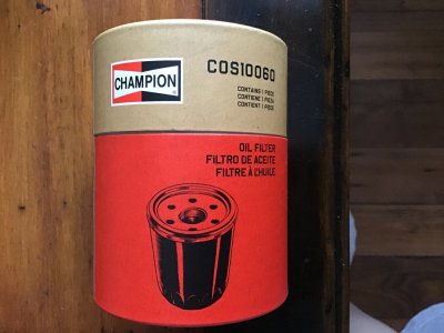

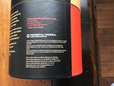

What does it say on package as far as manufactoring?

I wonder if Champ filters can't use the Champion name because technically they are championlabs and not champ labs, but Champion auto parts is much older then champion labratories, probably all trademarked up from way back. It would be real interesting where those are made, I think maybe not champ labs even though they really look like champ labs.

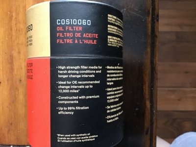

That's why they have a low price point, I think eventhough it's a blend, that could be a real contender.

It will be interesting to see one cut open. Can then compare the parts quality to the Tier 1 filters like RP, M1. Filter medium and particle rate will also need to be known. From what I have read and seen, the filter industry is going through change moves at the moment. Champion Labs appears to be making and painting more filters for more company's that used to make their own. Like the the recent change in battery manufacturing, the economics look like, if you have high capacity to produce you can offer the competition a private label filter that is no different than 4 other private label filters. Shall see. The thought of all or most oil filters being made in Mexico does not give me quality comfort.

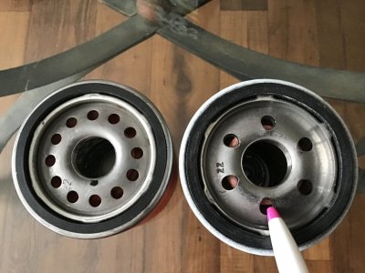

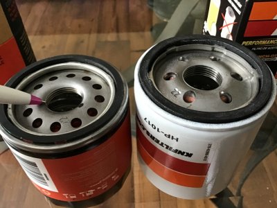

One thing I’d like to see on this Champion oil filters is better threads. Comparing it to a K&N you can see the difference is thread count. But looking from the top the K&N anti drain back valve is blocking the inlet holes, the Champion is wide open full flow. Filter rating is 20 microns on the Champion. M1 is the same way with the anti drain back valve blocking the inlet holes.
I really want to find an oil filter that has it all!
Note: I’m referring to the smaller oil filters.
