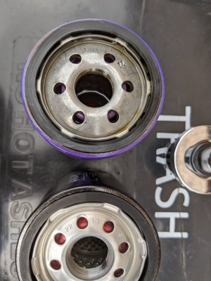

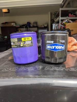

My last oil change I switched to the Purolator BOSS Filter Part No. PBL12222. My local Advance auto parts store keeps them in stock and I wanted to try it as a test. So far my truck idles smooth and runs great but its early yet.
I know @Burla doesn't like purolator but I tried it anyway lol

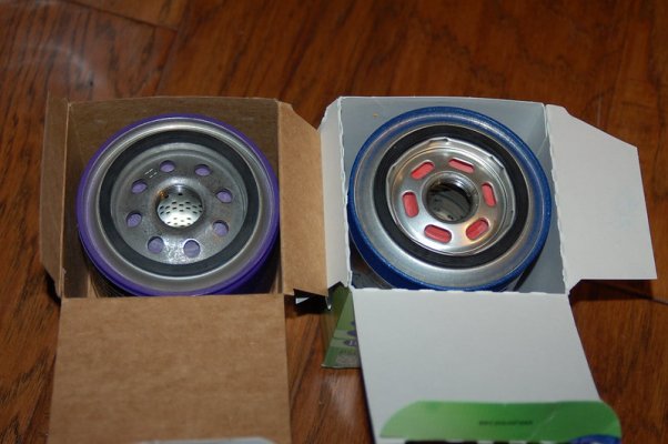

To clarify, I didn't like the results I got from Purolator and I have said it was old design, they changed the design shorty after I tested it. It was funny the factory video's didnt show a bypass, so I'm glad the reviewer did. Until you posted that review I didnt know if the new puro even had one. The issue with the puro I tested was bad holes in the cage, clearly that is no longer an issue. Thanks for review, Puro gets a Burla seal of approval.
The old issue you can see if you expand photo, not enough holes for flow. IMO a pretty bush league mistake, but it is good to see they really fixed it up nice. The big difference now is the way they bind the media, that plastic stuff versus mesh of RP, I have no opinion which is better, I just don't know. Bottom line it looks like another viable synthetic filter, thanks JB.

I wanted a good filter I could source locally, I saw this filter mentioned by some other members, did a little more research and decided to give it a try. So far my engine is running smooth and quiet.

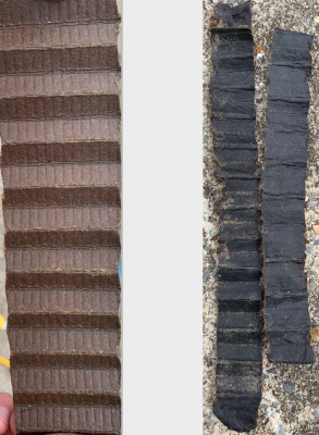

Was a bit harder breaking open this 2019 batch RP 10-48 than the OEM oil filter, but looks cleaner than the OEM..hoping the reason OEM had more metal flakes was because it was brand new engine and not because the RP ain't catching them and they all going back into the engine...unless I somehow shook the oil filter so much it ripped the flakes loose from the material (doubtful).
This is my second oil/filter change with 3,612 miles on Redline 5W-20. OEM oil/filter had 2,871 miles. Maybe it's pretty broken in and it's a super healthy engine now, but to me this comparison proves it's a safe good idea to change oil/filter before 3k miles on new vehicle. After 3k miles she seems pretty clean.
Left is OEM. Right is RP.

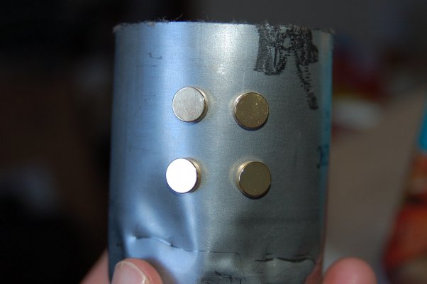

Thanks for cutting them open, if you want to see how much metal is in engine, many of us run magnets on the filters.
