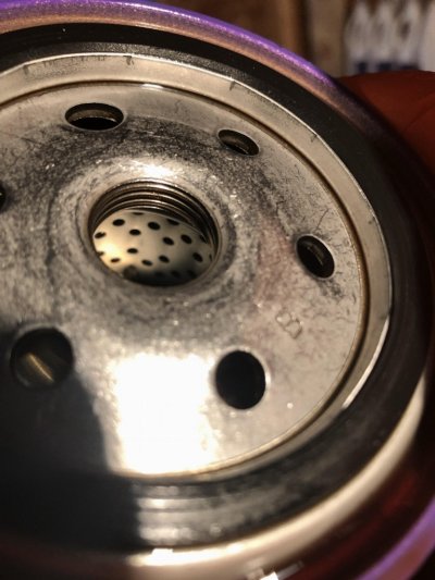

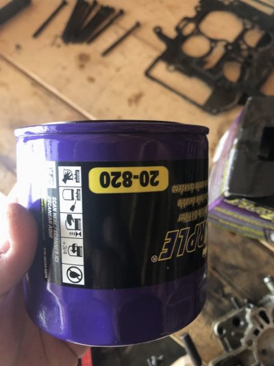

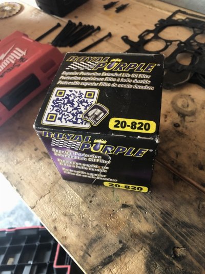

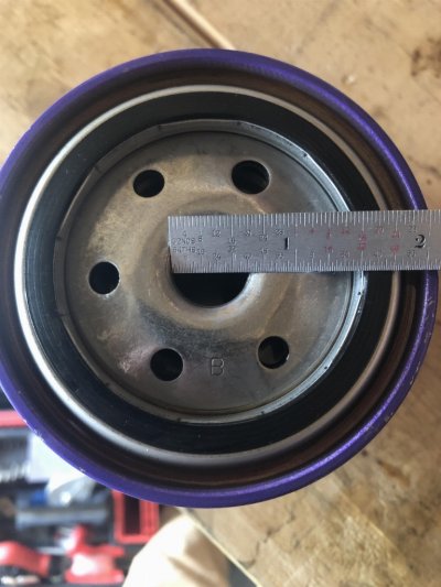

Recently I ran my stash of filters out, so I bought myself a single RP 20-820 filter to do an oil change on my Grandpas 2018 5.7. To my surprise, the threads are completely wrong. Way to small. Got to looking closer and the filter doesnt even have the “ZZ” thats normally stamped in the top of the RP filters. It has a “B” stamped in it. It is clearly marked 20-820. Has anyone else run into this?
Since I was in a pinch, I ended up using a K&N HP2010 that was available locally. Are these any good?

Sorry to hear it, every 20-820 has 8 holes in the past, there is an error somewhere.
From the first post, if you have to use paper filters those k&n are the best ones.
There is a production stamp or should be on top that also has date, do you have that?
Is there a cheese grater design still?

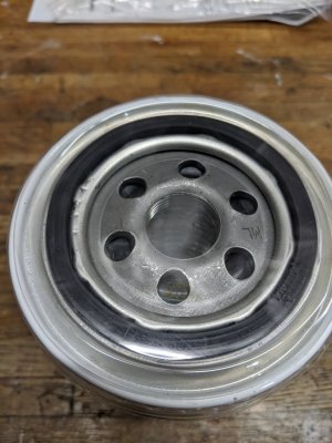

Interesting as I believe the one I have currently installed had the 6 holes as well. I got that sucker off Amazon.ca. Fits on my 2011 Ram 5.7 Sport and no leaks. Is there a diff design or a fake? I didn’t notice any markings on the filter. However, I didn’t know what to be looking for anyways.
The Amsoil which is the brother filter to the RP has always had 6 holes, so it could be that they just didn't put the 8 holes for the new batch, which is why we need the dates off the can if possible. 6 holes versus 8 shouldn't be a big deal, but of course wrong size main thread is fatal defect.
Also, those 6 holes appear larger then my 8 holes, so that would mitigate out equal in flow I bet.

Mine came from amazon US . Here is a pic of the date code and inside. It does not have the cheese grate type center. The bottom is dinged up, but it wasnt like that when I received it, that was from sitting it on a gravel driveway while rolling around under the truck trying to get the filter with the correct thread installed. 704c471df74cc030d3f05b1892765723.jpg
That is weird on so many levels I don't know where to start, man. If you ask me it appears they are throwing together old stock materials and putting out those filters. They actually have the fitment chart up again, otherwize I'd say it still looks like they will disco them.
As long as they fit, those are still top filters despite everything. But we really need to be diligent because any more shenanigans and we should start choosing another filter. I'd say amsoil ea would be were I went first

@Lyle Longboat & @14Tradesman thanks for bringing is good info, let's find out what is happening. Most of us have a lot of filters stocked up, so it will be up to guys without backstock to update if RP is still making a quality filter. With current info those still look like a great filter, absent the thread issue. But, it wont take much more to say look at amsoil ea and other filter first if there are any more issues.

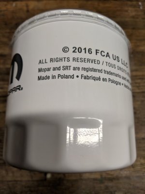

I really liked the quality of the srt filter I picked up at my local dealer. Packaging, materials and performance

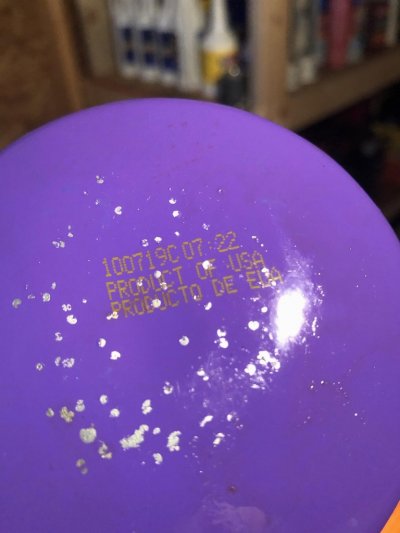

Well all she says is Made in USA and product number? No date on this ok girl. She’s still on my truck at the moment. I’m going to cut her apart on my next change to see what’s inside (first time with an filter).F152A5B1-4295-43A2-AC15-907ADAAB2CCF.jpeg

Just reviewing the numbers on both 14Trades and I’s filters and mine has the 07-17 and 14Trades has the 07-22 with the same numbers in the front.

I kinda figured 100719 was 10/07/19 (or 07/10/19)
