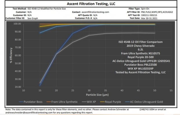

I guess I will have to add a line in my sig, page 93 the popular synthetic oil filters tested including wix which happens to also be mopar..
Wix XP might be the worst synthetic filter imo, but I'd still take it over paper. But why not just use the best synthetic filters? If you have to buy something it mise well be the best.

Fram > RP @ <25 um?? :banana-mario: jK

The XG10575 is listed as 16-28psi on fram.com, coincidentally the highest rated filter in burla's graph also.
If the xg2 is 12psi and 20-820 is 11-17psi, unless it's truly 16psi+, I'm still curious what makes the 20-820 > xg2.
