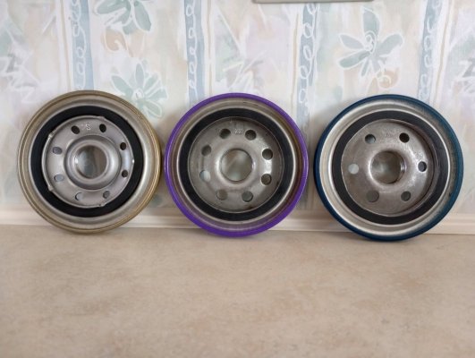

Here is some pics of the three oil filters(In order: FRAM XG2/Royal Purple 20-820/FRAM Endurance FE2)that I cut open for taking a gander at the insides for comparison.
The base plates on all three are hefty. The RP20-820 and FRAM Endurance FE2 base plates are about the same with the exception being the RP 20-820 has two more inlets than the FRAM Endurance FE2 where the FRAM XG2 has the same amount of inlets as the RP 20-820, but smaller.
