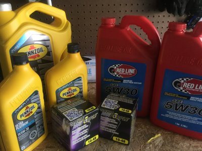

I’ve never went for expensive oil filters before but everyone I know around me that has Rams tell me to go with a K&N oil filter. First I’d love the thoughts of you all on that. Second what’s the difference between the Hp-1017 and the HP-2010, other than the obvious length difference? Is there any reason to go for one over the other? None of my friends have told me there were more than one available. Maybe I’m missing something but both would fit. I know my tractors have different available oil filter sizes, but that’s just life expectancy and oil change duration stuff as far as I know. Any thoughts would be great. 8b4d8b663a4be974db1587de41bc219e.jpg

I believe it has to do with the 8 speed trans, if you have- you want the shorter one because its a tighter space. However I think I read somewhere on here both will fit, of course I can't find that thread right now.. also for what it's worth, after all my research I decided to only use oem mopar filter- same price as those on amazon

If you're ordering an oil filter online, I would NOT run a K&N filter, they have poor filtration vs others for the same price. The Royal Purple EL filter has one of the top filtration rates of any of the synthetic filters. If you're planning on running extended oil change intervals then you 'd want the longer filter for more duration but if you follow the standard oil change interval then you can get the shorter filter ad not worry about it.

My 2 cents. I worked for champion labs for almost 15 years. They make royal purple K&N and many other brand of oil filters. They make filters of all kinds for most of the OE's and lots of others as well. K&N is basically a standard filter. Paper media like most out thrrt. You are buying the name and the 1" nut on top. Royal purple is a synthetic media that is far superior to the paper media. I believe the metal shell is thicker also. They all have to meet minimum specs to be on the shelf, so there isn't much to worry about as far as quality in general. When I do my own, I alternate between a supertech (Walmart brand) made by champion labs and Mobil 1. The Mobil 1 is basically the same as the purple with different paint label and box. Much cheaper and on the shelf at Walmart every time I need them. The supertech filter is a cheap one, but has a slightly better than bare minimum paper quality. Had to do that to get the automation to handle it reliably, so therefore was cheaper than the cheapest paper. Use whatever filter you feel comfortable with, just my little bit of info.

I know this is old but from personal experience, the K&N filter with the nut on the end was terrible. Shortly after the oil change I noticed I was leaving puddles. Found that oil was somehow leaking past the nut.
I know I didnt over torque it and I'm not sure if its welded on or shrink wrapped under the label film so I'm not sure what happened.
Now I use Mobil 1 M1-113. Quality filter without any gimmicks.
Also I believe the HP-2010 was too wide to seal properly, I returned it, and ended up buying the HP-1017 or vice versa.
Edit: just confirmed I was using the 1017. The 2010 was to wide.
