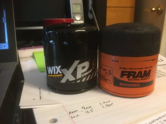

Had the same or similar issue on my’19 Laramie 5.7l. Always did my own oil changes using Pennzoil full synthetic and Fram Ultra Guard filters. After 60k miles it developed a small oil leak that was dripping off the steering rack. Knowing it’s electric power steering it had me stumped. Took it to the dealership. $140 later they said it was left over oil from the last time I changed oil. Knowing that wasn’t the case I changed the filter again with another Fram Ultra Guard. Still had the leak. Went to Autozone and compared Fram filter to a STP filter. The STP filter gasket was about twice as wide and thicker than the Fram. Bought and installed it…no leak. Bought a Wix filter on Amazon and it has a gasket similar to the STP so it is going on with the next oil change. Don’t know why after 4 years the Fram filters started to leak unless they changed their design or manufacturer but I’m not going back.

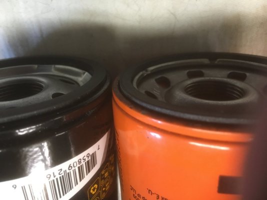

Correction. Went out today and found it is the Fram Extra Guard not Ultra Guard that I use. While out I measured the gaskets between the Fram Extra Guard and Wix XP. The Fram measures 4mm wide and 1.4mm thick measuring to the metal rim of the filter. The Wix measures 4.5mm wide and 1.8mm thick. Not going to Autozone to measure the STP filter gasket but it, like the Wix, was visibly wider and thicker.

Picture of the gaskets would work better.Flip the filters over so we can see them
