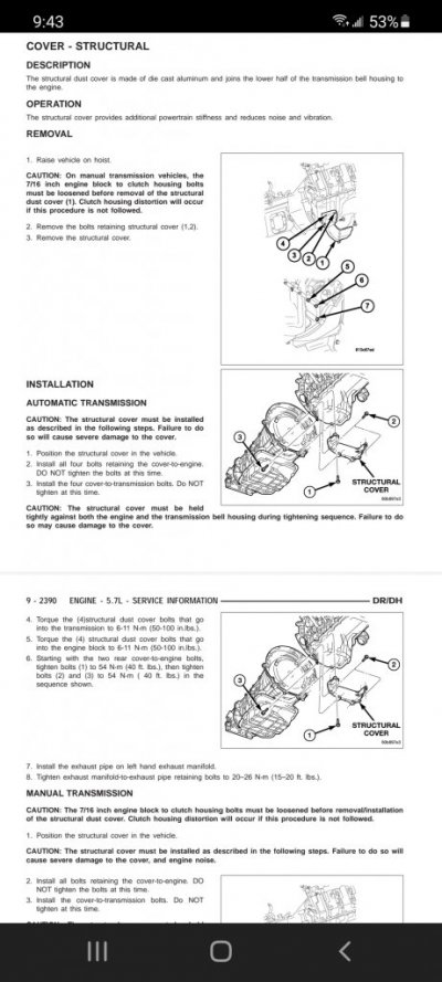

There's a "bracket" of some sort blocking my view of the bolts along the back edge of the pan. I found a pic online of what looks like what I'm talking about and the arrow is showing what's in the way.
Is it OK to remove that? I think about 6-8 bolts. Will it just drop out? Will there be any fluid gushing out (like do I need to drain the transmission fluid first)? If I remove it, do I need to put a jack/stand underneath anything to keep it from dropping?
Basically, trying to find out if I remove this bracket thing, will I be crushed by something or covered in anything?

You're safe to drop that bracket. There is a specific tightening sequence in the shop manual for reinstalling it though

Ah, wouldn't have known that part... the sequence that is... what's the part called? I'll need to find that in the pdf since I'll assume also a torque spec as well.
