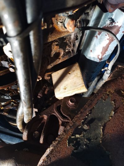

I have been struggling with getting this done over the weekend. I debated whether to raise the engine or drop the differential. It seemed easier to me to raise the engine. The cross member came out easily enough. The transmission mount nuts came out easily also. The motor mounts went easily enough. The biggest issue was the 3 differential bolts. Those took far more time than I ever expected, and when I got them out, it was getting dark so I decided to work on it the next day when I got home.
I jacked up the engine using a piece of wood on my floor jack, and jacking it up from the bell housing. The next struggle was figuring out how to support the engine since the TRQ video I was using for directions didn't show where they put blocks to wood to do so. I eventually figured it out.
That pan didn't want to come loose from the pan. A couple of bonks with a rubber mallet only showed how bad the pan had rusted as it put a hole in it. I eventually worked at it with a putty knife between the gasket and the pan. It took a while, but the gasket came free.
The rest of it went well until I was putting the new pan on. Every bolt would hand thread in except for one. No matter how many times I tried that bolt would not thread properly. I am not sure if the threads have an issue or if the pan is somehow keeping it from going in straight. It was getting dark again, so I stopped for the night. Today we had worship with our church and then family over for Canadian Thanksgiving so I will return to working on this tomorrow.
My hope is after giving it some time and coming at it fresh I will be able to get it to thread. If not, since everything is just finger tightened, I will remove all the bolts, pull the pan out of the way, and see if I can get it to thread in then. If I can, I know it is just a matter of moving the pan around. I will hand thread that one near the beginning, and leave on more accessable for the end. If I can't get it to thread, I guess I will have to run a tap into it and see if I can clean up the thread.
Below are images of how I supported the engine using blocks of wood at the motor mounts.
