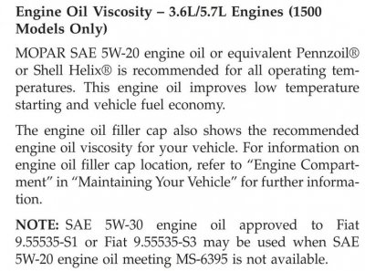

My wife's 2017 Grand Cherokee calls for 0w20 in the owner's manual and on the oil cap. There is no 0w20 or any other 0w conventional oil so I have to use synthetic oil in her 3.6.
If it were me, I'd be using a synthetic in any 3.6
Chrysler specs 5w20 for the RAM 1500 with the PENTASTAR engine........
