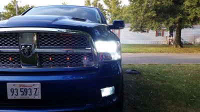

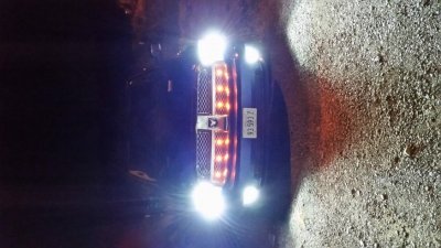

I had a hard time choosing myself but I finally pulled the trigger on the Opt7 leds (size H11) for my low beam headlights and the JDM ASTAR led's (size 9145) for the fogs. I love the JDM ASTAR brand and have every light on and in my truck... fogs, front turn signals (which are the white to amber switchback bulb), 3rd brake light, reverse, licence plate, and all interior lights.. installed with the "Extremely Bright" series from JDM aside from the headlights which are the Opt7 brand and my tail lights which are an aftermarket assembly from Spectre. The only bulb that gave me any trouble as far as the "error bulb out code" that i had to install a load resistor on was the front turn signals. The Opt7 leds have resistors bult in and are completely plug and play with all wiring hardware included with the purchase. The headlights and fogs are the same 6000k color temperature and both are ridiculously bright. I included screen shots of my purchases from amazon and an installed picture. Hope this helps.

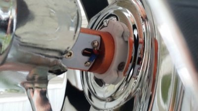

Here are the pics I said I'd post.
Pic #1.. you can see how the circuit board sits in the assembly at a 45°angle. The white side of the board has one diode and same on the other side of the bulb. This causes pic #2 to look the way it does when viewed from a set point. Notice that in the lower left and upper right of the head light it looks dark. That is because the light doesn't completely fill it. Reflective light does come from these areas as you can see in pic #3 if viewed as a whole light it does light up all over.
Those pics were taken of the drivers side. The passenger side is the same way, just a mirrored. Take those pics and turn them over and it's as if I took them from the passenger side. Just didn't want any confusion as to if the passenger bulb would be sitting the same direction as the drivers side causing the passenger lower left and upper right to be lit up like the drivers side. No, the passenger upper left and lower right have the darkened spots.
Anywho, like I said in my last post. It is a great light and it does just what I intended it to do. It's all about preferences in the end.
