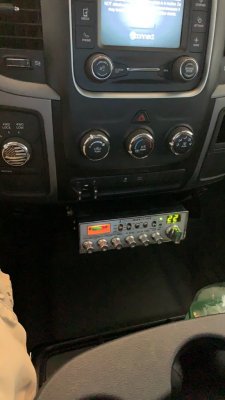

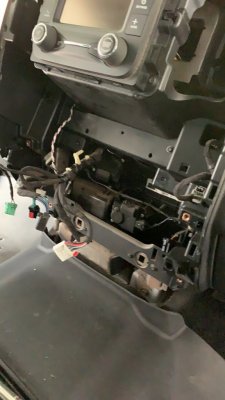

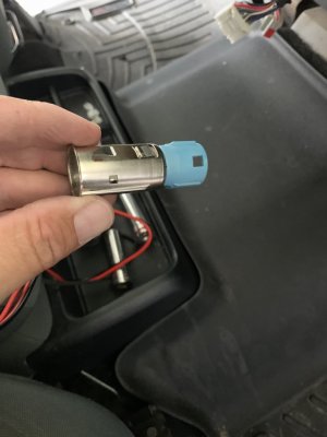

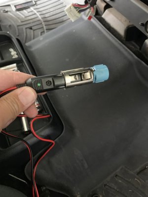

im wiring up my cb radio. I removed my lower drawer and am going to mount it in that spot. Power question. I have the cigarette power adapter “that’s what I call it”. I removed my keyed power plug on drivers side and my question is..... Can I plug it into that. Tape everything up and tuck it all behind the dash like that? Instead of having it sticking out the port. Also I don’t really want to cut or tap a turning. This way it’s just a simple plug everything back in if I sell. I just don’t wanna start a fire lol. I think it would be fine taped up so nothing touches and it don’t wiggle loose. Any advise

Haven’t ran antenna yet. My plan is for a 4’ fire stick mounted behind the cab on bed rail. Also haven’t got the cable yet. Wanted to make sure it would mount up and look ok or I was gonna go handled. I think I’m going to get 15’ and if I have to wind it up under truck and tie it up I will. Hopefully it all works well. This is an old ass cobra 29 my dad had when he was trucking which I remember as a kid lol.
