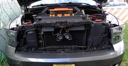

Yep, that's them.
I had to cut the factory plugs off and use crimp terminals as the PIAAs are universal spade terminal type. No biggie.

my 2010 is easy since they mount right under the hood latch.
I think later years they're behind the left fender liner somewhere.
Used a test light to determine hot lead on the factory plugs, then cut 'em off & crimped on female spade connectors to both hot & ground. 10 minute job.

They have several different models but the ones NJ has are I believe 112db.
They are indeed.
They sound like the old car horns from the 60s, loud & obnoxious.
Not like air horns, just deep & loud like they know it's a truck honking.
