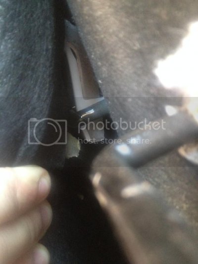

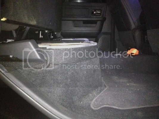

With a 1.25" lift how much of the rear seat clip is still in the bracket?

Not sure exactly, a pretty good bit though. I'll snap a pic when I get off work in a little bit.

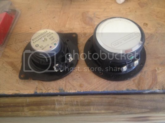

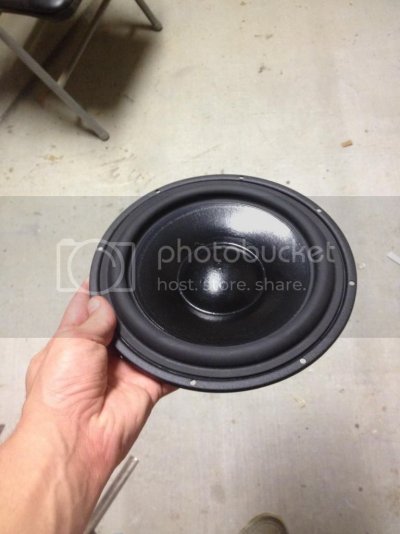

But, i did get the HAT L3s in. Here they are compared to the stock speaker..
Little monsters. I didn't want to give up the DLS but because of their size I was forced to.well... I'm glad I did. The L3s take more power, play lower, and have a MUCH more natural tone than the DLS. These play like a champ down to 150 hz and really brings the sound stage up quite a bit. Only had a few minutes with them before I had to yank the 8s out the doors.

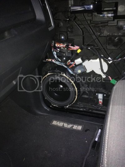

Rushed home with my 1 door speaker bumpin. Managed to get the other one in fairly quickly. no need to show how i did it again...
only pic. verrrrry close to kick panel, which means verrrry close to inner door panel but no fitment issues there.

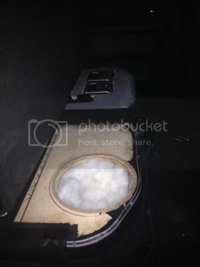

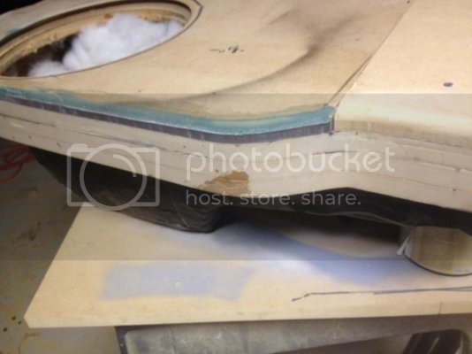

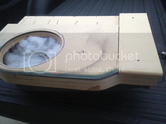

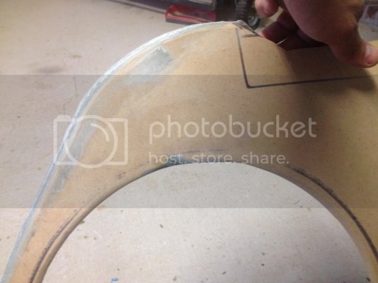

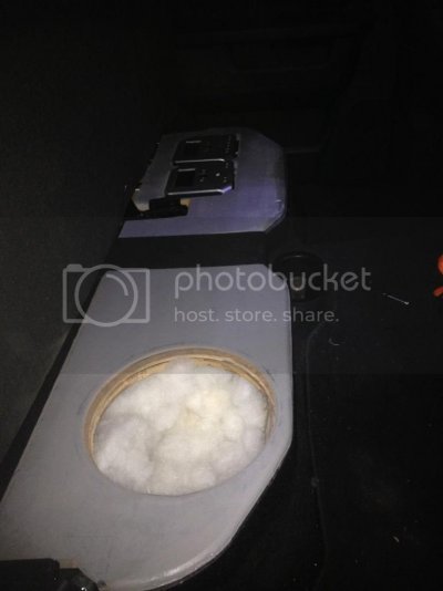

Enough of that...Im ready to get this box and amp rack over with. Heres how I left it... Sub box with dynaglass to smooth and also to fix that little router Eff up...
not perfect yet but better

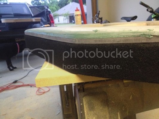

Amp rack carpeted, primed, and lexan hit up with lens tint. Not happy with it at the moment...
First off, the lexan cracked and didnt fit flush enough in some spots so i cut a new peice...
then some dynaglass to make the fit tight...

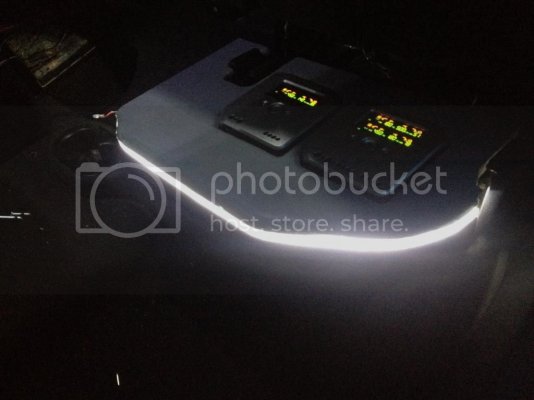

Next i stapled the LED strip to the underside of amp rack cover. Not sure if i ever showed it but i routed the edges for lexan to fit under it...
Damn near impossible to get a decent pi in the dark...
Amp rack is basically done. Im waiting for suede to come in to cover the top and thats a wrap. Now the sub box.

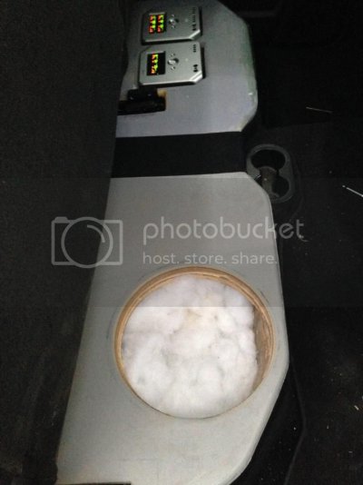

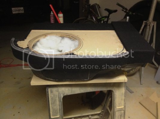

Heres the mock up of the center piece that will be carpeted to break up all the surface area of all this when its done.

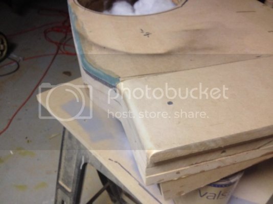

Flushed and rounded
Never thought i had it in me to make all this $hit fit together nicely... the box, baffle, lexan, and divider... Not too bad

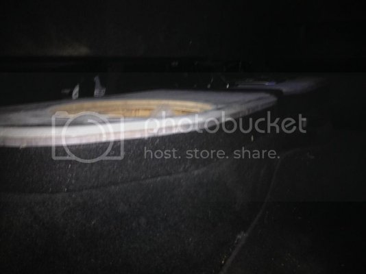

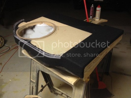

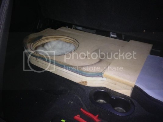

Carpet time! This part always makes me excited bc u know its getting close.
test fit it all all to make sure i didnt F up somewhere along the way...
Worst pics ever in 3...2...1...
Like the money shot in a 70s *****. hazy, not sure whats actually going on but i bet its pretty bad ass!!!

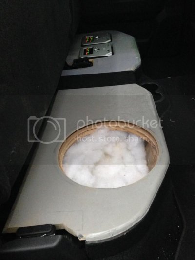

Snapped these this morning.... A little better.
As u can see, I need to sand down the edges that were dynaglassed...
