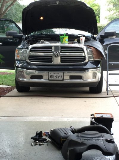

Finished all but cylinders 5 and 7, which are the ones underneath the vacuum booster for the power brakes. I’m pushing 70 and my back is killing me, gonna rest and eat before facing these.
I feel you. My FIL has a topside creeper that I used when I did mine. It was a blessing, but I had a sore abdomen from laying my fat a$$ on it.
Do you have the Gearwrench 80546 magnetic swivel spark plug extension? Worth every penny.
Yes, I ordered it from Amazon before starting this job.
BTW, there’s a damn good reason why NONE of the YouTube videos show anyone using a torque wrench on cylinders 5 and 7!
Luckily the plugs are new, so you can feel when the washer contacts the head, feel the period of near-constant resistance as it crushes, then give it “just a little more” when the tightness suddenly increases.
