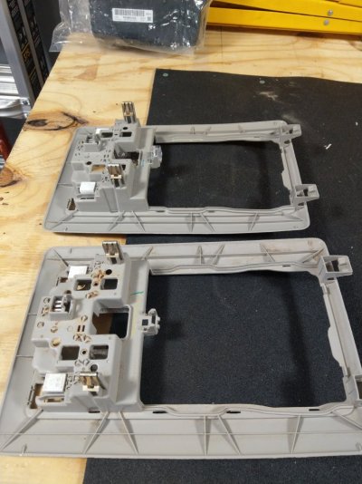

Any thoughts if one clip is not engaging due to its slot being wallowed out?
I have two outer bezels with the brass clips but not the inner bezel...

Here is a sketch and a pic which I believe show the backup plate or bracket that the clips on the overhead console plug into.
My problem is the dealer tech wallowed out my slots so one clip won't catch.
You could probably build up the damaged opening with layered pieces of electrical tape to tighten it up again. It might pull out the next time you take it down but you could just repeat the process.
In addition, you can access almost everything you need to by removing the inner portion of the bezel and not the outer so this could be a permanent fix unless you need to remove the headliner for some reason.
