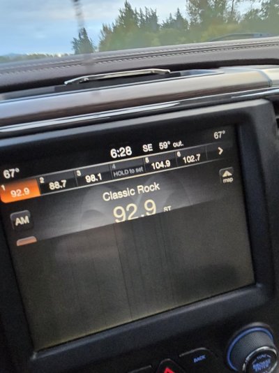

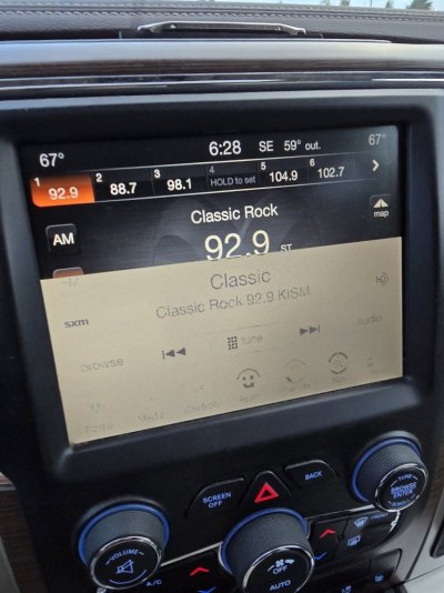

When it warms up the screen starts to flash/glitch white and eventually goes black except for the very top. Touch screen still works. Works fine when it cools down or cold out. Help please....

If it is like other membrane type screens I’ve worked on, the connector that goes into the motherboard is probably loose. Sometimes it can be reseated and fix your problem. Sometimes. I bet when you go over bumps it improves? Take it apart and look for loose ribbon cable connections.

I appreciate your advice ibike. It does not respond or change to rough road or bumps. It is 100% heat related.

The liquid crystal becomes crystallized at higher temperatures and loses its reflectiveness, this is why the screen starts to get darker and eventually goes black. With a 2015 it is possible the radio just is getting to the point of failure or it could be something that has happened such as a broken vent connection in back that is placing hot air right at the metal cooling fins of the radio that dissipate heat as air passes over.
The cheap fix is you have to get a constant stream of cool air on the back of the radio. Also consider a visor to block all sun from hitting it. You could also send the radio out for repair, probably replace the entire LCD screen which you might be better buying an aftermarket one someplace like Crutchfield. The only repair shop I know of is on the East Coast, United Radio in Syracuse NY. I have had good luck with them repairing a couple units over the years.
