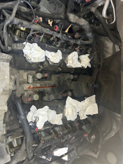

Last night I got both valve covers off, all the rocker arms seem fine and tight other than one of the ones at #5 which is where the misfire is. There is a small amount of play there, but not a lot. I am taking all of this one step at a time and going slow so forgive me if this is a dumb question. But do I have to remove the radiator, serp belt, timing cover, ect to inspect and replace the lifters. I get that I would for sure if I have to replace the cam shaft, but I have a small camera I can send down the hole to inspect that part. My thing is do I need to take all of that off in order to replace the lifters.

I got the intake off. I get that the cam is most likely going to need to be replaced too, but am I able to just get the lifters out without taking all the radiator and stuff off the front. I haven’t gotten to the part yet of taking the heads off, that will be my next job. Is it possible to take the heads off without taking the radiator and stuff off?

Yes you can remove the heads with-out removing the rad. Make sure you drain the radiator and try and get at the block plugs to drain as much coolant as possible out of the engine.As soon as you pull the heads you'll have coolant everywhere,with alot of ending up in the oil,so plan on doing an oil change as soon as it's back together,before you even attempt to start it.
Before you pull the heads,remove the VVT solenoid at the front of the block,and check it over for metal flakes.Lots of video's on you tube showing how to remove the vvt solenoid if you don't know what it is.

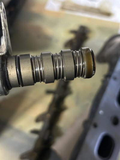

That is your VVT solenoid, it's held in by 1 bolt. It comes straight out toward the rear of the engine.
You likely will have to turn it slightly left and right to get it out. Be careful.
A FEW WORDS OF WARNING:
Plastic clips and plugs can be very brittle from the heat.
When I unplugged my VVT solenoid, the white end inside the plug fell off. Also the clips for the wire harness that you see to the right of the VVT plug and next to the MDS solenoid for cylinder 4 fell apart into several pieces.
Make sure you remove them and/or account for the pieces, so they dont fall in somewhere. I didn't see mine had broken until later. Be careful.
The screen on the VVT solenoid might give you a clue. Here's what mine looked like:
You can see there's very little metal flakes on it. Sometimes, there is alot, and that can mean replace the engine.
As @Wild one said, if you don't know how to remove the VVT solenoid, watch some videos how to do it.

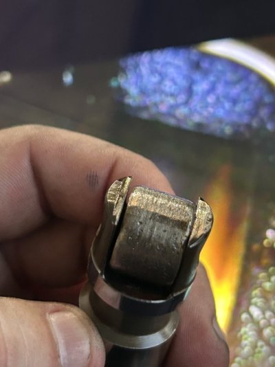

Ok so I have gotten to the lifters after much frustration. The 1st lifter on #5, where I had the misfire code was completely locked up. The roller was frozen, but I was able to unlodge it and it rolls with some play in it. The rest of the lifters were perfect. Using a camera, I looked at the cam shaft and it looks the same to me in each hole. I attached a picture of the lifter damage and a video of the hole to the cam shaft. I’m just a novice so I thought I would get recommendations from others that had cam shaft damage. Does it look like I have any damage there to have to replace the cam shaft?

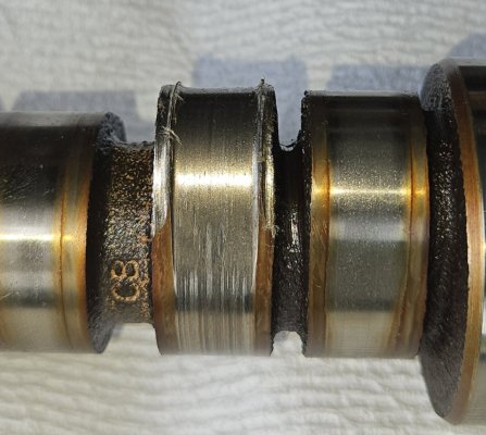

Your cam lobe is gonna have damage, did you get a look at the end of that cam lobe? The wear will be on the highest point.
I think your video does not show the tallest part of the cam lobe
The end of the cam lobe has worn down the ears on the lifter body.
Here was mine:
Here's the end of my lifter:20250609_102019.jpg
And the bad lifter next to a still good one:

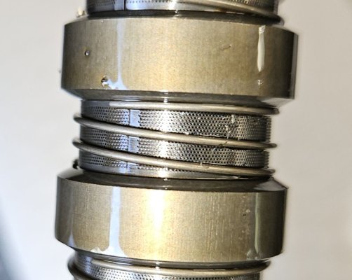

I looked at all four cylinders on the driver side and they all look fine. The VVT had a couple very microscopic metal pieces

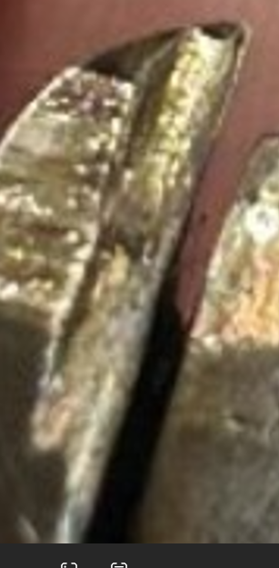

No way your gettin outa this without replacing the cam.
The spot I zoomed in on here is where your cam lobe and lifter body tried to occupy the same space, at the same time:
Put a socket on the harmonic balancer bolt and rotate the engine until you can see the top of the cam lobe in that hole. I'm pretty confident that its gonna look worse than fido's butt.
