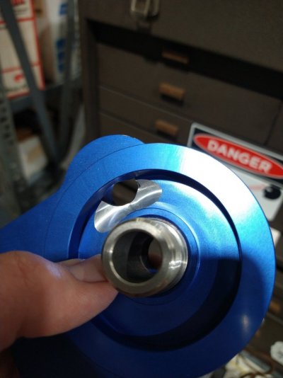

My kit showed up and I'm happy with my purchase, it's a very complete quality feeling kit. I like the design of the block side adapter for sure. I did think that the filter mount could be blended in a little better, though I'm sure it would not be a restriction at all. I just have to improve things when I see them.
Before and after a quick little massage with a ball endmill.
