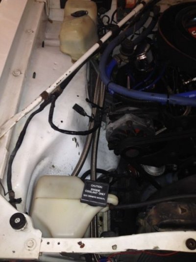

Nicely done! Filter relocations are one of the best mods! Especially on vehicles in which it's a PITA to get to filter. My '89 Diplomat Police package had a factory engine oil cooler so I relocated filter up front near the cooler. Attached to rad support next to cooler. Best mod ever!
