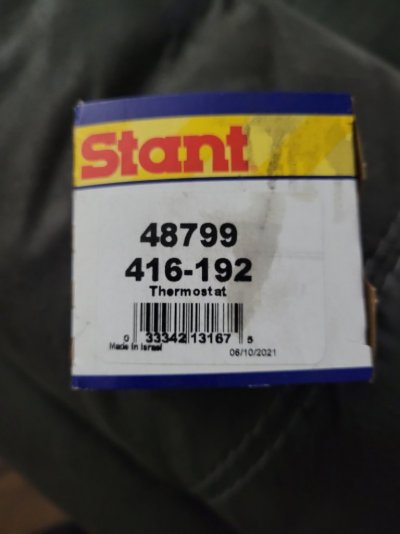

Here ya go, rock solid at 190.
190 Degree; Includes Seal
Stant XACTstat thermostats include all the features that make them just like the original equipment. They have the jiggle pins, check valves, integral seals, and integrated water outlet housings. Some have the ports for attaching coolant sensors.

Jan 17, 2016
23,721
54,479
14 Sport
Features and Benefits
These thermostats are an exact match to the original equipment thermostat that came with the vehicle when it rolled off the assembly line.
  • Includes all features of the original equipment thermostat
  • Jiggle pins and check valves for air venting, integral seals, and integrated water outlet housings are exactly like the original equipmen
Thank-you
