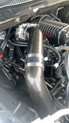

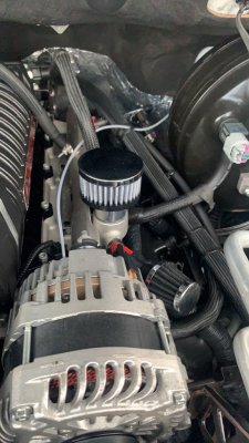

For those of you with whipples on your rams what are you running to combat blow by into the whipple. I had a catch can and a small filter on the whipple intake below the oil cap, but the catch can was filling up extremely fast causing oil to puddle up into the intake. I have since added a Metco breather filter with check valve in place of the oil cap. I was debating on removing the PCV valve and capping off the oil barb filter now that I have the Metco breather. How are you guys running your systems?
