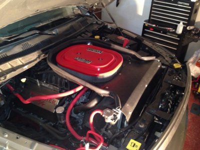

Lance, I think the problem you are feeling with your intake is that you did not remove the radiator cover. That is where the air is being pulled from, so with that cover still installed, it is not getting near as much air as it should. Try removing that and make another run to see what the truck does.

Tried that too
Matt, beleive me I'll try just about anything you guys lead me too. That didn't help either.
I thought after the drop I would be faster because I just didn't sit and spin. But now it just feels slow....

As for the intake, have you reset your computer so that it relearns the new mods? If you did not disconnect your negative battery terminal before installing the new parts, then I would go ahead and do that. Just leave the negative terminal off for about an hour.
We have numerous customers that have dropped anywhere from .2-.4 seconds off their 1/4 mile times with the intake alone, so we know that it works. We have also seen consistant dyno gains as well. As someone that sells all the intakes available, the Vararam is the one I chose for my own truck because I know that it is the best performer out of the bunch.
