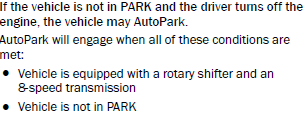

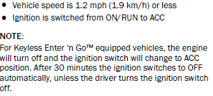

OK, but I just spent 15 minutes looking through my manual in the same section you showed in yours and the '30 minute' thing is not there.
WHAT Jimmy07 said, post #8. They will shut down after 30 minutes, pasting what I found in 2023 manual. The keyless entry addendum, still applies to your truck.
NOTE: (FROM 2023 manual, page 121/2).
For Keyless Enter ‘n Go™ equipped vehicles, the engine
will turn off and the ignition switch will change to ACC
position. After 30 minutes the ignition switches to OFF
automatically, unless the driver turns the ACC SWITCH TO
off.

That only references the 30-minute thing IF you turn the engine off without first putting it in Park. See my above Post #12.
The note is attached to the auto park behavior description, but it is only saying that because that’s what happens in ANY event, not only because auto park happened.
You are reading too much into what is printed: You are debating 2 diff things. The auto park option is a safety system and automatic if those conditions are met..
You putting/pushing the Ignition button to ACC is a separate function. And it will still time out at 30 minutes, timer system wired into circuit/TIPM.
