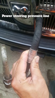

Just pulled this line off. Last official line in the system. Looks a little dry rotted. Put it all back together and pump stopped whining. Praying this was the cause.
