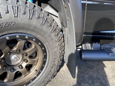

I elected to go with genuine Mopar, as I've been satisfied with all my previous items from them. So these are the part numbers for a 2019+ HD with fender flares. Fit the PW perfectly.
Front 82215928AB
Rear 82215929AB
They're made of heavy EPDM rubber, quite flexible so they shouldn't take any damage from sliding down a rock shelf or boulder. You'd have to be reversing and trap them against a large obstacle to do any harm.
The mounting is really solid; uses 2 existing screws for the flare and adds 4 plastic rivets. So 6 fasteners on each flap, and it ties together with the flare, the little mini splash guard at the bottom, and the inner fender liner.
I may source some nylon or SS screws later to replace the rivets, just so if I wanted to remove them temporarily for some rock crawling I could easily remove / reinstall.

Travelin Ram: How are the Mopar mud guards working out for you? I am looking at getting the exact same set for my 2020 Power Wagon that I just picked up. Any chance you could post a few pictures of the mud guards on the truck and how the fasteners attach?
Miller Rowley
Jul 5, 2020
Queen Creek, Arizona
Thanks for the pictures, trucks look great. Looks like there is some new hole drilling required on the fender flare and the wheel well liner where there is no factory fastener right?

Yes that is correct. It is 3 extra fasteners needed per unit it to secure it properly. You are only drilling into plastic.

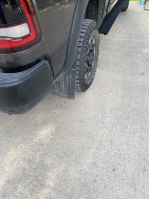

Anyone have a set of Gatorback mud flaps on their Power Wagon? Looking to order some as I'll be towing a small trailer on occasion.
Thanks!
