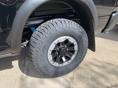

392
Brand: BFG AT KO2
Size: 35x12.5 R17, E Rated
rubbing: None
MPG: 14-15
Off road performance: Excellent, except in mud
Wet performance: OK, but not great
Highway comfort: Quiet, much better than stock, but they have to be rotated and balanced every 4k miles or they start to vibrate
Snow/Ice: Unknown
Lift or level Required: None
Tread life: Unknown yet
PSI: 50 front, 45 rear

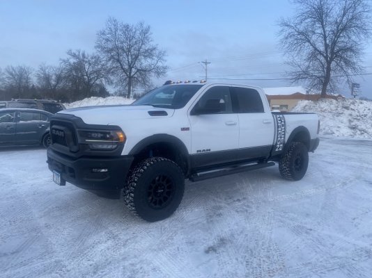

Thanks. Still trying to get used to the Methods. They are kind of boring compared to my Fuel Blitz DDT's. I jsut didn't think the blitz's in the 18s with the positive offset would have looked as nice. Less dished.
