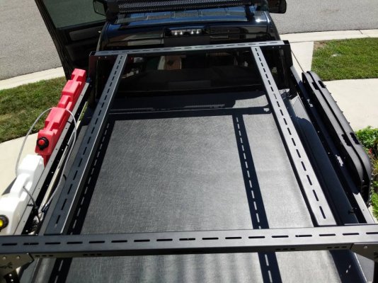

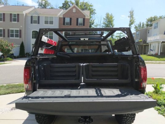

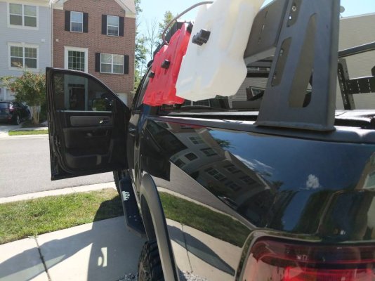

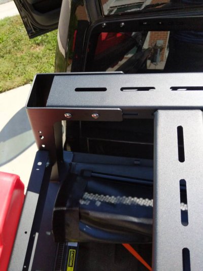

Finally got a bed rack installed. Still have a kink to work out with the top cross bars. I went with a 18" tall rack from victory 4x4, they typically build yota and jeep stuff. This one was listed as "universal" close but not quite. As I started putting it together since our beds are roughly 1.5" wider than a tundra I was only able to get one bolt in the cross bars as seen in the pic. I contacted victory and they are sending me out longer cross bars to remedy the issue. I decided to slap it together any way just for kicks. I'm actually pretty impressed with it. There is a slight overhang on the rear vertical posts but other than that the fit is pretty good. Powder coating is nice and mounts up solid. Another plus is I was able to fit my roll up tonno cover on. I only plan on doing the rotopax, recovery boards and a awning soon. I'm super happy with it budget was a big factor for me as this was only a bit over $800 compared to other offerings for power wagons which are well over 1k. I'm super happy with how it turned out. Should have the new bars in Wednesday and I'll try to snap more photos.72c051f4f80dd397c4b7332dd41b9c0c.jpg437c3a63a675da29dc9f80575195892a.jpg28db0b0a89e22eb28b949706cf922ae4.jpg129c857a37c8372c5a22ec096ed913b6.jpg67bf25be938097ac9b373ef3f69548f6.jpg

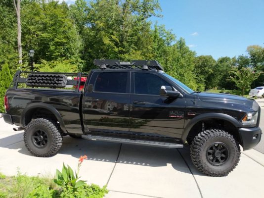

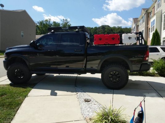

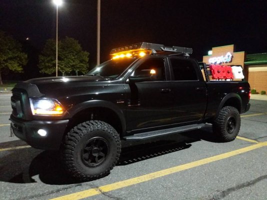

Got my new bars in, definitely much better. In the process of the install I realized our beds taper in at the tailgate by about 3". Had to modify the rear bar a bit by extending the bolt holes slots. Other than that the install was great. Really happy with out it turned out. I may shorten up the rear bar to match the gaps on the front but not sure yet. My OCD of not having the gaps equal bugs me. 633c7ddb77d0b7f01d682ba7be36193d.jpg43370e30a2bb4fd3661e43a6261e29e2.jpgf1dfb0c3ce166e9fe61afac3edad6aa7.jpga1323a78b1219163b582a9dc47fef85b.jpg45cfaebd9c533631b4e579cd5aa76eaf.jpg5b8a10144ed7a9b34950a2093abc0bc2.jpgc357e9d4fbc2d4e2d44d523b94d97837.jpg2363df418293448b4973215460d3e39c.jpg

Very Nice!!! I like the rack...need one for mine that works with the rambox :)
