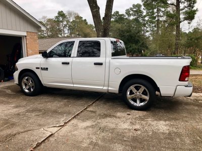

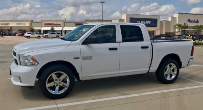

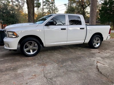

I didn't see too many reviews on the Pro Suspension 272920 2" drop springs, so I wanted to post my review and some before/after pics. I've put a couple thousand miles on the springs and I love them. I ended up getting around 1 3/4" drop on both sides, although the right side is about an inch taller, which drives me crazy, but it was like that before the drop.
On big bumps I did get a little swaying motion from the rear, which I didn't expect, but found out it's somewhat common when you lower the rear. I ordered and installed a Hellwig rear sway bar 7709 and wow. I would say it eliminated the swaying over bumps by about 99%. I know it's a big ol truck, but she can handle her own in the corners now.
I hauled my dirt bike this weekend, 2012 KX450F, and the rear squated about 1/2". The dirt bike weight 250lbs. I didn't think that was too bad. I was driving on some crap roads and hitting some big bumps at 70-80mph and I never hit the bump stops.
Now, the before and after pics. I put on new tires this weekend, General Grabber 295/50/20, so I posted after pics with both tires. I did A LOT of research on this tire size, but found mixed reviews on whether or not they would fit/rub. They fit and don't rub at all.
