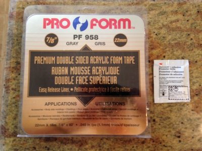

Here's what I used.
It's auto body grade adhesive. You have to first use an adhesive promoter on the badges (once you've cleaned them).
Worked Great!

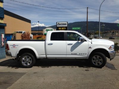

I removed the door badges and moved them to the lower door panels.
I liked the new look. I found stock placement to be too crowded.

Tip: If using the emblem tape I mention in a previous post, remember to use the foam tape adhesive promoter on the badges and not the door!
Tip: Clean off any residue on the door before applying badges with something that won't affect the paint. I used goof-off regular not the strong but I believe you can use anything with an alcohol base and not solvent based. Confirm with a professional before you use anything.
On install, for spacing, I started the first letter 3/4" down from the straight door line and 1-1/2" from the left of the door edge. I measured down from the straight door line 2-1/4" and ran some green painters tape that enabled me to mark my spacing and ensure a straight line. The letters were spaced 1/2" apart at the closest edge. I used 5" spacing between the Ram letters and start of the 3500. From there I spaced the numbers 1-1/2" apart.
On the passenger side, I had to reverse and start with the numbers. 1-1/2" from the right starting with "0" and then 1-1/2" between numbers, over 5" from the "3" to the start of the RAM letters then 1/2" between the letters.
I had my truck in for service recently and everyone was coming out and pointing at my truck. Everyone liked the different look! Nice and clean with no clutter.
