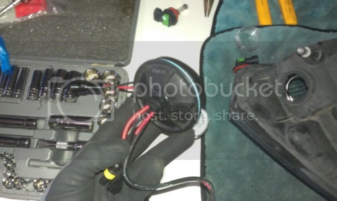

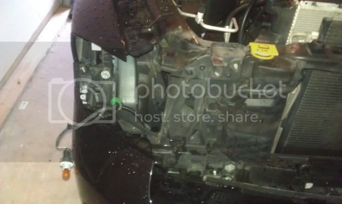

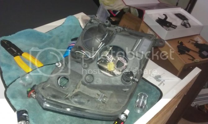

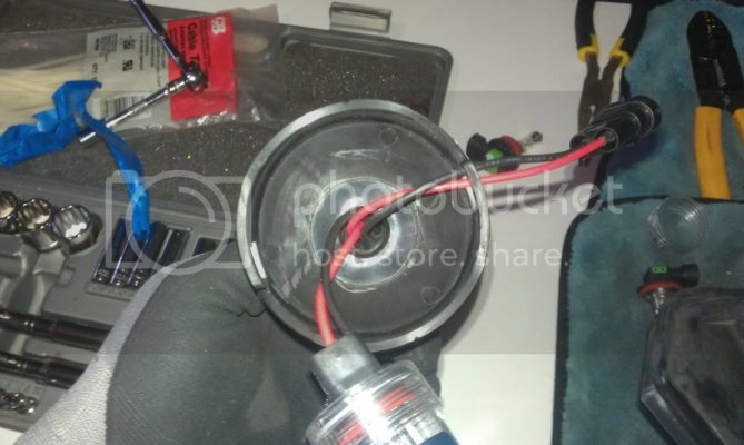

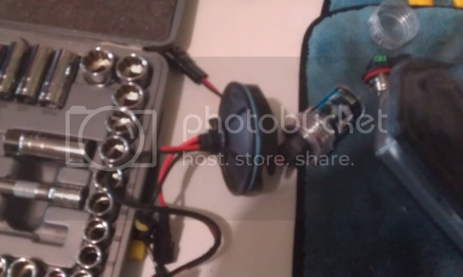

so got up this morning and i went outside was freezing but started on my truck finally got all four of my HIDs in heres some pics i took
after i took out the grill and headlights
took off the cover and drilled out a whole with my dremel and feed the wires through

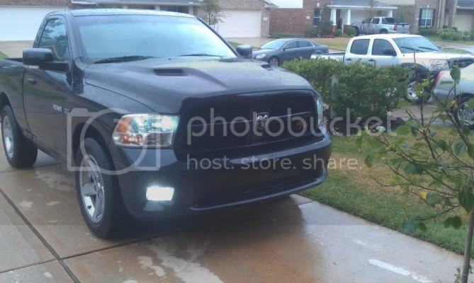

tested my lights all good :D
put it all back together

Why thank you also after I did this my dads friend finally showed up to tint my Windows :D lol 20% up front 5% back

Some trucks seem to work without the harness, but I don't trust it. Why chance it?
On the housings, if you drill into the dust cap and use the grommet that comes with the HID bulbs, you will be fine. I use a 1" hole saw, but a 7/8" will work great too.

So was I or.using a canceler on the wiring but I tried it with out anything still have it.like that no flickering no warm wires nothing heating up unusually so for now I'm gonna leave it like this for a little bit until I get a new harness for it.
But you can always add some silicone between the gromet and housing to seal it better
