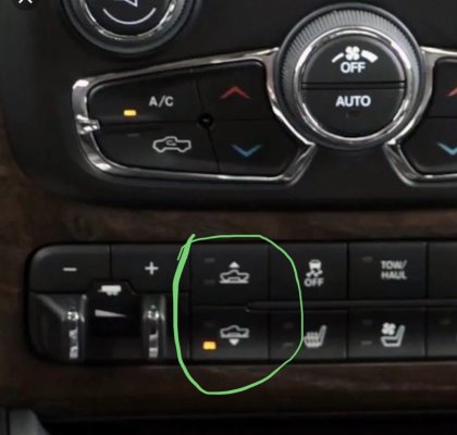

Down there on the switch panel below the knobs and the climate controls you’ll see the buttons I circled down below in the picture.
From where it’s at now in OF2 mode, push the down button once; it’ll lower the truck an inch and display to OF1 in the center cluster which is off-road 1 mode. Push it again, and it’ll drop some more to normal ride height. Push it one last time and it’ll lower to the lowest setting and show entry/exit mode on the instrument cluster. 1c63f946afd5b3f3e153702de172bae0.jpg
